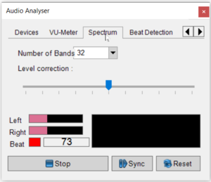

Spektrum

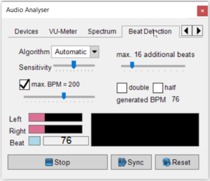

Beat Detection

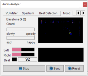

Mood

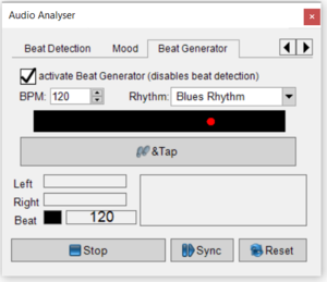

Beat Generator
