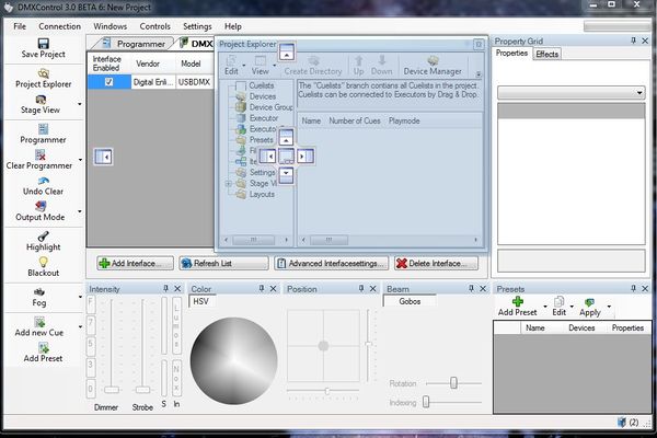

The forms in the program can be left to float above the main window or can be docked to the top, bottom, left or right margins. This versatility give you the power to build screens that are easy to use and tailored to your personal preference. Catch a form with the mouse pointer and move the pointer over one transparent arrow to dock the form at wanted place. A form can also be made to occupy the left-over space in the middle.

  • The docking suggestion is a symbol indicating the options where a form can be docked. It is available both in the main window as else in each pane. The potential position of the form is indicated by a blue rectangle.
